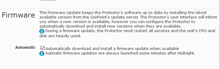

Protector not starting up anymore
This morning I started a Firmware update from the console. After 4 hours it was still telling me that it was running but nothing happened. On the web interface a message was displayed that the system stopped updating at 59%. I chose the option to resume the update but nothing happened. At 13h00 I decided to restart the system. Now the system hangs at "Starting up X11 session manager". I have no more access to the system. What do you suggest to do?
Type
console
to force firmare from console
Constant Red Light on SFF Unit
yes, the red indicator is HDD light, it says hard drive in good working.
Meanwhile the Firmware update was succesful
We also ran the Kernel Update succesfully.
So now the status is entirely green again.
Thanks for the support! Keep on the good work.

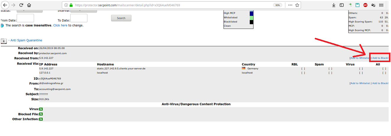

How can I block IP ranges that are hammering our Mail Server?
If someone are hammering your protector mail server you simple click Anti Spam Listings and Hard Block Listing & TLD
There you can add their entire IP CIDR range to block them off.

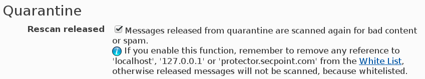

Outgoing reports quarantined
I have configured the Protector to send Webfilter reports on a daily basis. The reports get into the spam. When I want to release the report it ends up again in the list of quarantined e-mails.

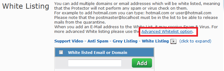

I whitelisted the localhost but still the problem persists
The row is green, which means that the email is whitelisted. All the emails processed by the Protector are visible in the quarantine, not only spam.

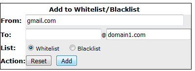

Hard Block Addresses
You already have implemented a hard block sender list... but;
Would be nice to implement a hard block *recipient* list so that the mail archiver log would be more clean for non existent e-mail addresses or unwanted or terminated mail addresses.
Another solution would be to block sender (to:) addresses from the mail archiver self.
Please try this way
it's possible to blacklist a recipient, but the only way to do it is this:
Go to the advanced white/blacklisting page https:///spprotector/spamstatistics.php?query=lists
and add a new entry like this picture, and then restart the Anti Spam engine on the home page.
When you want to white/blacklist a sender it's different, because you can leave the to: field empty, so this made me think it was not possible to do the same for recipients. But forcing the text "default" it works.

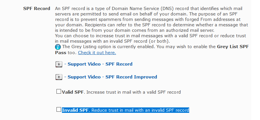

We get T_SPF_PERMERROR with SPF
In the protector we get a T_SPF_PERMERROR for the from @ourdomain
Checking in mxtoolbox we see no problems.
v=spf1 mx a a:exchange.ourdomain include:_spf.ourdomain include:_spf.ourdomain include:_spf.afas.online.nl -all
In the protector we get a T_SPF_PERMERROR for the from domain
We have found the problem, one of our hosted cloud services has changed the include:_spf.afas.domain (this didn’t exist anymore)
We changed it to include:spf.domain which is the new correct spf record.

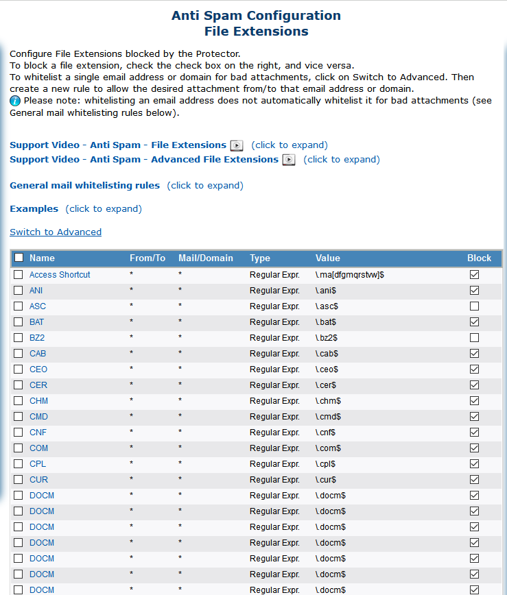

Anti Spam File names being blocked
Why are the 2 filenames blocked:
The real file names of these 2 files are:
"xx-xx-xxxx_xxxx_xxxx xxx _week_1.pdf"
"xx-xx-xxxx_xxxx_xxxx xxx _week_2.chr"
and they match the rule "White Spaces"
IP Address to blacklist question
How to easily add a spam senders IP address to the blacklist?
It can be done easily by clicking as shown in the Image

Whitelist rule Question
There was a whitelist rule from domain.com to anotherdomain.com but we removed that immediately, does it take sometime before that takes effect?
On the otherhand the message detailed that the message was MCP whitelisted..
The anti spam engine must be restarted for the changes to take effect. This may not happen automatically when the changes are done in the advanced settings pages (in the mail archive).

How to add correct regex for file attachment blocking
The correct way is.
.doc$ instead of .doc$
Long file name being blocked in email
Sending a file name like:
xxxx-xx-xx xxxx xxxxx; xxxxxxxxxxxxxxx, xxxxxxxxxx, montage enz.pdf
Is getting blocked.
This is the rule that matches. The file name is too long
Does HA work between a 32 bit protector and a 64 bit unit?
It is only supported by 64 bit to 64 bit unit.
Mail Attachment being blocked
Allow the filename TEST.RPT.pdf match
Unchecking this rule, the mail is not blocked.

Whitelist question CIDR
We would like to whitelist the following IP subnet.
xxx.xx.0.0/17
I've added the entry into the whitelist, but mails from an IP within this subnet is still being blocked.
Am I doing something wrong in here? See attached printscreen.
Thanks in advance,
The mail doesn't accept CIDR notation, but it accepts partial IP addresses to whitelist a network. So, the range below should be replaced by xxx.xx. with final dot.
It will whitelist more than the /17 CIDR, but if it works as expected, it can be refined later.

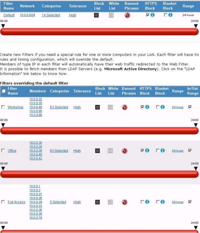

How can we block Skype and Teamviewer?
The Skype rules in Anti-Chat and Teamviewer rules in Policy under Content Filter menu.
And, it's possible to add the skype and teamviewer domains to the webfilter blacklist.
The protector will find and block all the IPs of the blacklisted domains. For example, skype uses 16 DNS entries from dsn0.d.skype.net to dsn16.dsn.skype.net.
Please click menu Web filter - setup, then click on Black list for the default filter. There they can add domains. There are 2 videos in the page.

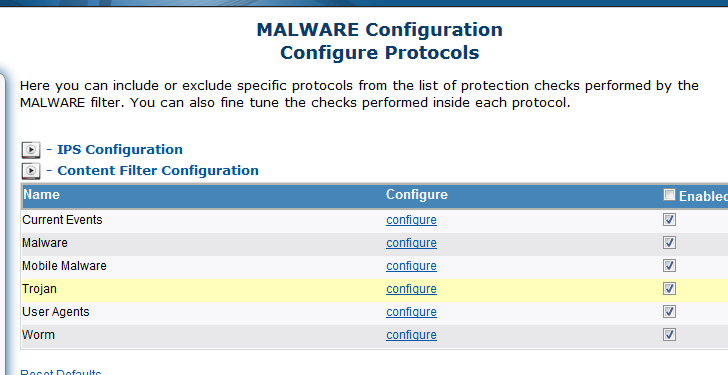

How to block Ransomware?
Ransomware falls in the category of trojans, so it is there that you can find it. Menu IPS - Anti Malware

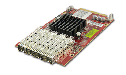

How do Firewall Bridge mode work?
We can deliver an appliance with 2 SFP ports where the customer can put the SFP adapters and cables locally.
For the firewall only mode it will run in Bridge mode support at the moment since it is tuned for UTM usage.
With the bridge is running, you cannot create zones on each network card, because what crosses the bridge may come from outside or inside.
So you can't create rules on a network card and this is a restriction that you have to take into account.
Only 2 netports can be used for incoming and outgoing and a third port is for DMZ.
We need to make sure this meet their requirements.
So they can start by using the normal netports that are 1 gig and upgrade to the SFP later one when their load increases.
Please confirm the requirements of the firewall they need that the Protector fit it 100%.
The protector runs in bridge mode where they put the router in port A and the local lan in port B.
They can also configure a DMZ zone in port C.
In the firewall menu it is possible to set profiles.
Here we have a guide that explains more.
https://www.secpoint.com/manual/SecPoint-Protector-Firewall-Setup-Guide.pdf

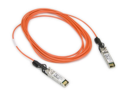

Do the Protector UTM Firewall support SFP ports?
Yes this way it is possible to gain high speed 10 GB
Small Form-Factor Pluggable Gigabit Interface Converter,
SFP

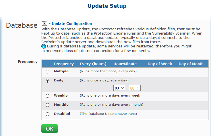

Firmware Update
How can I Enable or Disable Automatic Firmware Update on the Protector?
Please visit the Update menu and Setup page
How can I change ET POLICY RDP or ET POLICY MS?
I can find ET TROJAN etc
The configuration of Policy rules is in the Content Filter page. Click Content Filter on the menu, then click Configure next to Policy

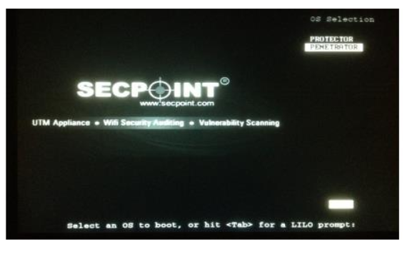

NFR Multi boot for partners
Our Box/Unit is a NFR Penetrator, however, the software inside the box is a Protector UTM firewall.
The system is Multi boot NFR.
It means for partners only it is possible to get a box that has BOTH systems
NFR Multiboot Protector Penetrator

How do the Web Filter work?
  HTTPS |                             |
  block |                             |
        |           OFF               |                   ON
Blanket |                             |
block   |                             |
         | http: blocks categories     | http: blocks categories
         |       blocks BL             |       blocks BL
         |       passes WL             |       passes WL
         | https not blocked           | https: - --if proxy is not set on browsers
   OFF   |                             |         |  - blocks BL (by extended IP address list)
         |                             |         |  - passes WL (by domain's IP address)
         |                             |         --if proxy is set on browsers
         |                             |            - blocks all domains except WL
         | (1)                         | (2)
         | http: blocks all except WL  | http: blocks all except WL
   ON    | https not blocked           | https: - --if proxy is not set on browsers
         | (3)                         | (4)

How can I turn off Invalid SPF check rule?
By clicking:
Anti spam - Setup
Here you can easily turn it off.
Invalid SPF Record

Another strange example of blocked file
How can I prevent this false positives ?
The customer receives a lot mails with false positive blocked file which I cannot explain. Also allow in file extension does not help. Or must I add a new regular expression, how?
The attachment with double extension matches this rule. Disabling it, the attachment will be accepted.

If I whitelist an email or domain will RBL still block it?
No RBL wont touch it.
If the email of the user or entire domain is in the whitelist it wont get triggered by RBL.

I am getting spam from my own domain
I am getting spam that looks as it is coming from my own domain:
Example:
in this here case if the domain is secpoint.com
the spam would appear as it comes from [email protected]
To solve this you need to make sure your own domain is not in the white list.
Example if you navigate to
https://YOURIP/spprotector/setuplists.php
Then make sure your domain is not listed there.

Whitelist not working for all computers within the same group
The issue  is that 2 computers in the same webfilter group have different behavior when browsing websites.
What's the group and what features have been set for it?
Can we have an example of unexpected behavior?
At present time the behavior of the webfilter is supposed to be as this scheme:
  HTTPS |                             |
  block |                             |
        |           OFF               |                   ON
Blanket |                             |
block   |                             |
   OFF   |                             |         |  blocks BL
         |                             |            blocks all domains except WL
         | (1)                         | (2)
   ON    | https not blocked           | https: not blocked, regardless of
         |                             |        proxy settings on browsers
         | (3)                         | (4)
SecPoint Webfilter Config

Do you support Fiber ports?
For a UTM Firewall we need to run four ports UTM only , for fiber port and Ethernet 10G ports is this available ?
In the standard appliances Ports on board are 1G, thus 10/100/1000.
NIP-52041 PCIe Gen2
PCIex4 - 4xFiber - Intel I350-AM4  - AI3-3454
Transceivers 1000Base SX and 10/100/1000Base T can have a multiple vendors, but all should work with our card.
We recommend the Finidar transceivers, but Cisco, HP, Dell and others should work fine as well.
End customer usually select transceivers, because they know what kind of switches are installed.
For fiber or high speed we support:
    1x 10G copper with 2 ports that must use a Cat 6, Cat 6a, or Cat 7 cable.  (spec suggesting to use CAT6a)
    1x 10G fiber with 4 cages
Intel® Ethernet Controller XL710 based Fiber Network Interface Card with 4x SFP Ports and PCIe 3.0 x8 Interface
    4x fiber SFP ports
    Support PCIe Gen3 x8
    For fiber card cable and transceiver are not included
SecPoint Fiber

SPF Check Question
I enabled the SPF check a while ago.
Since then I had the idea that some messages, when the SPF check fails are being forwarded to the customer.
Today I received a spammail from EMAIL, only containing a .doc file.
The mail has been sent from Vietnam, the IP isn't listed in our SPF record.
Yet the mail was delivered without warning or block.
MessageID: vA3DJAN6003865
The SPF check is intended to increase trust in mail messages with a valid SPF record, without affecting the score of messages without. So, if a message does not have a valid SPF record, it's not treated as spam.
If you see, the message score isn't altered by the SPF score, because it doesn't have the SPF
The behavior seems to be as expected. The message , tested on the command line, fires the rule T_SPF_TEMPERROR, that has a score of 0, so it doesn't cause any change in the overall message score, and this is coherent with the behavior of the SPF filter in the Protector: increase trust in mail messages with a valid SPF record. On the other side, when a message has a valid SPF record, like in , it receives a "bonus" score of -10 thanks to the rule SPF_HELO_PASS.
What could be done in the next firmware is add more options to the SPF filter, in order to:
- decrease the score score for every valid match: SPF_PASS,  SPF_HELO_PASS
- increase the score for every invalid match:
T_SPF_PERMERROR,
T_SPF_TEMPERROR,
T_SPF_HELO_PERMERROR
T_SPF_HELO_TEMPERROR
SPF_FAIL
SPF_HELO_FAIL
SPF_HELO_SOFTFAIL
SPF_SOFTFAIL ​

Block non admin users from adding domains to blacklist?
I’m currently looking for the option to block non admin users from adding domains to the blacklist.
Can you tell me where to find it?
The block is automatic, and the new behavior is as follows:
User: can white/black list an email address or a domain, but only for messages with the user itself as recipient (email-address to User, domain to User). So, all the other users are not affected.
Admin: can white/black list an email address or a domain for all the users in the system (email-address to All, domain to All).
The only warning is that all non-privileged users should be created as User, not Admin.
When I release a Spam from Quarantine it gets scanned again
The message I release from quarantine keeps getting rescanned and categorized as spam again how can I solve it?
It is probably because you have this option enabled. Please disable it and release the mail.

IPS DB Update
How often is the IPS Intrusion Prevention Databases updated?
The IPS block and the Web filter work independently. So, a worm will be blocked even if there is nobody surfing the web.
One type of protection can be obtained with IPS, another type with the web filter.

Whitelist question
I have a question/issue.
When I add a domain/sender as whitelisted as Admin, this entry is added to "default". Basically means that the domain/sender is whitelisted serverwide.
Now, the issue is that, when a user adds a whitelist entry, the entry is being added to "default" also.
Currently we have the issue that one of our customers is adding gmail and hotmail as whitelisted. That the customer whants this is fine by me, but I don't want those domains to be
whitelisted for everyone.
How should this work normally?
Reply:
When anyone adds an email address or domain to the whitelist, it's whitelisted for all the domains hosted by that Protector. So, if you are hosting two domains (domain1.com and domain2.com) and you whitelist gmail.com, gmail will be whitelisted for domain1.com and domain2.com. This is the way it works.
If you want to whitelist from gmail to domain1 and NOT from gmail to domain2, you should create the whitelisting rule in the advanced page.
Here, enter both domains, From and To, and select Whitelist, then Add
SecPoint Protector White Listing
SecPoint Protector Whitelist
How can the Protector UTM Firewall block Wannacry?
I cant find the Wannacry blocking in the Protector when I look in IPS configuration?
Wannacry is not in the IPS configuration, it's in the Anti Malware setup page, in the Trojan page
SecPoint Protector Malware Block

File Extension Block
How to make file extension rule based on from (email or domain) to Email/ domain
The option From/To Email/Domain is in the advanced settings of the File Extension page. Click on "Switch to Advanced"

How to block File extention in the Anti Spam Module?
To block by regex you have to click the other radio button,  not file extension.
The reg exp must have single backslash, not double.
Please see the screenshot:
SecPoint Regex Blocking
Release message, blocked other
I have some emails that are blocked under other, when I release them
they are blocked again
It may be because the Rescan option is enabled in Antispam-Setup

Web Filter Block Groups
I consider this also but can we block group of users via username? Via ip address and via mac addresses?
Users can be blocked by IP in the Web Filter.

Protector Database Updates
How often are Database updates carried out on the Protector UTM Firewall?
The default for database update is once a day. You can customize it very detailed.
Please see screenshot:
In Update -> Setup menu
SecPoint Protector Daily Update

What time do the Firmware Update automatically?
The automatic firmware update is launched a few minutes after midnight.

Can you set a time based Web Filter blocking policy?
Yes.
You can easily set up Web filter groups to block things such as social media or other categories in specific time zones.
It could be in a work environment where certain things are allowed outside of business hours or during lunch.
Then in specific times as specified the web filter will activate again.
You can also setup group policies so each group have a different policy all together.
Example a sales department group has a specific policy on.
And a support team group has another policy.

How can I block Dangerous Macros?
How can we block the macro dangerous files.
You can easily add file extensions in the Anti Spam File Extension blocking menu.
Please see more information at:
(https://www.file-extensions.org/filetype/extension/name/microsoft-office-files)
file extension dotm
Microsoft Word Open XML macro-enabled document template
file extension ppsm
Microsoft PowerPoint macro-enabled Open XML complete slide show
file extension pptm
Microsoft PowerPoint macro-enabled Open XML presentation
file extension xlsm
Microsoft Excel Open XML macro-enabled workbook
 file extension docm
 file extension xlam
Microsoft Excel Open XML macro-enabled add-in file
 file extension xlm
Microsoft Excel macro
file extension xltm
Microsoft Excel Open XML macro-enabled workbook template
file extension ppam
Microsoft PowerPoint macro-enabled Open XML add-in
file extension potm
Microsoft PowerPoint 2007/2010 macro-enabled Open XML template file
 file extension mam
Microsoft Access macro shortcut file
 file extension sldm
Microsoft PowerPoint 2007/2010 macro-enabled Open XML slide file
It is recommended blocking attentions such as:
OCM, XLSM, PPTM
This can help block specific Malware as well.
See more here:
https://blogs.technet.microsoft.com/mmpc/2016/02/24/locky-malware-lucky-to-avoid-it/
https://isc.sans.edu/forums/diary/Locky JavaScript Deobfuscation/20749/
It can also be recommended to block javascript extensions .js
