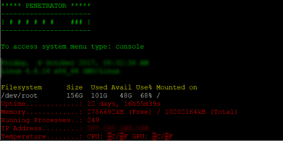

How can I change Penetrator IP Address from console?
From console menu
Menu point 14-15

When i try login for putty to the appliance this show me the attached image
Please press ALT F6 or Please press ALT F7
How to easily see IP address history of vulnerabilities?
You only need to select 1 IP, then it will show you up to the most recent 36 scans. Then you can click on one of the scans and it will give you the status of each vulnerability.
How can I access the system console in the Penetrator?
Type console to get the menu.

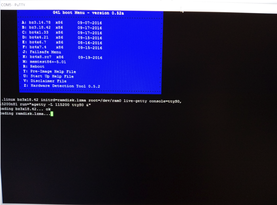

G4L boots up I can type but nothing happens
Booting g4l i can type but nothing happens.
Solution:
1: ok boot g4l
2: press tab at boot menu so you can type parameters
3: Make sure it has: live-getty console=ttyS0,115200n81 run="agetty -L 115200 ttyS0 &"
